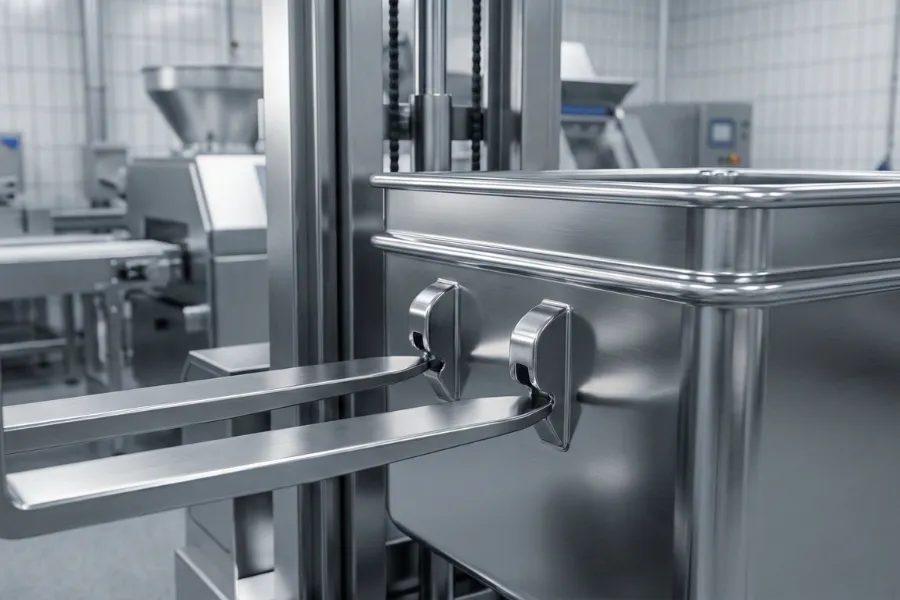

Here comes the key standard: DIN 9797.
It is she who defines the standard of ‘Euro-trolley’ (Euro-Bin). Whether you call it a cymbr or a stuffing trolley, the product must meet rigorous dimensions to be compatible with loading devices (wolves, mixers, stuffers).
If the trolley does not follow the DIN 9797 standard:
  • The tipper will not ‘grab’ the truck stably: the risk of a fall of 200 kg of load on the floor (or employee).
  • Wheel locking: Incorrect wheelbase will prevent access to the loading platform.
  • Cover problems: Standard plastic or steel covers will not fit on the distorted edge.
Stainless steel Euro-bin (stuffing trolley) 200L docked to a column dumper loader, complying with DIN 9797 standard.
Whether you call it a bin or a trolley, geometry is key. Pictured: A Tracz trolley perfectly aligned with a standard column dumper, eliminating the risk of jamming during production.

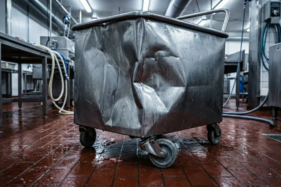

Why do “cheap” trolleys break on welds? failure anatomy
When we hear from customers: ‘The competition has a cymbra 15% cheaper’, we usually ask one question: how much does this stroller weigh?
In the metallurgical industry, miracles do not exist. The price of the stuffing trolley is 80% due to the price of the material and the man-hour of the welder. A cheap stroller (often imported from the Far East) looks identical only in the photo in the catalog. In the production hall, the differences come out after the first 3 months of intensive use in a humid and saline environment.
Cracked weld seam and crevice corrosion on a low-quality stainless steel stuffing trolley (Euro-bin).
The result of cutting costs on materials. Micro-cracks and corrosion in welds are caused by using thin steel sheets. These crevices harbor bacteria (Listeria) that high-pressure washing cannot remove.
Sin 1: Steel Uneven (1.4301 vs. Rest of the World)
The standard in the food industry is AISI 304 acid-resistant steel (1.4301). It is a material that is almost indestructible with proper maintenance. Cheap substitutes are often made of steel with reduced nickel content or thinner sheet metal (e.g. 1.5 mm walls instead of 2 mm). effect?
  • The trolley under a load of 200 kg of meat begins to ‘work’ and deform.
  • Fatigue microcracks appear.
  • Plasma and brine accumulate in the crevices – an ideal environment for bacteria and corrosion that the Sanepid will not forgive.
