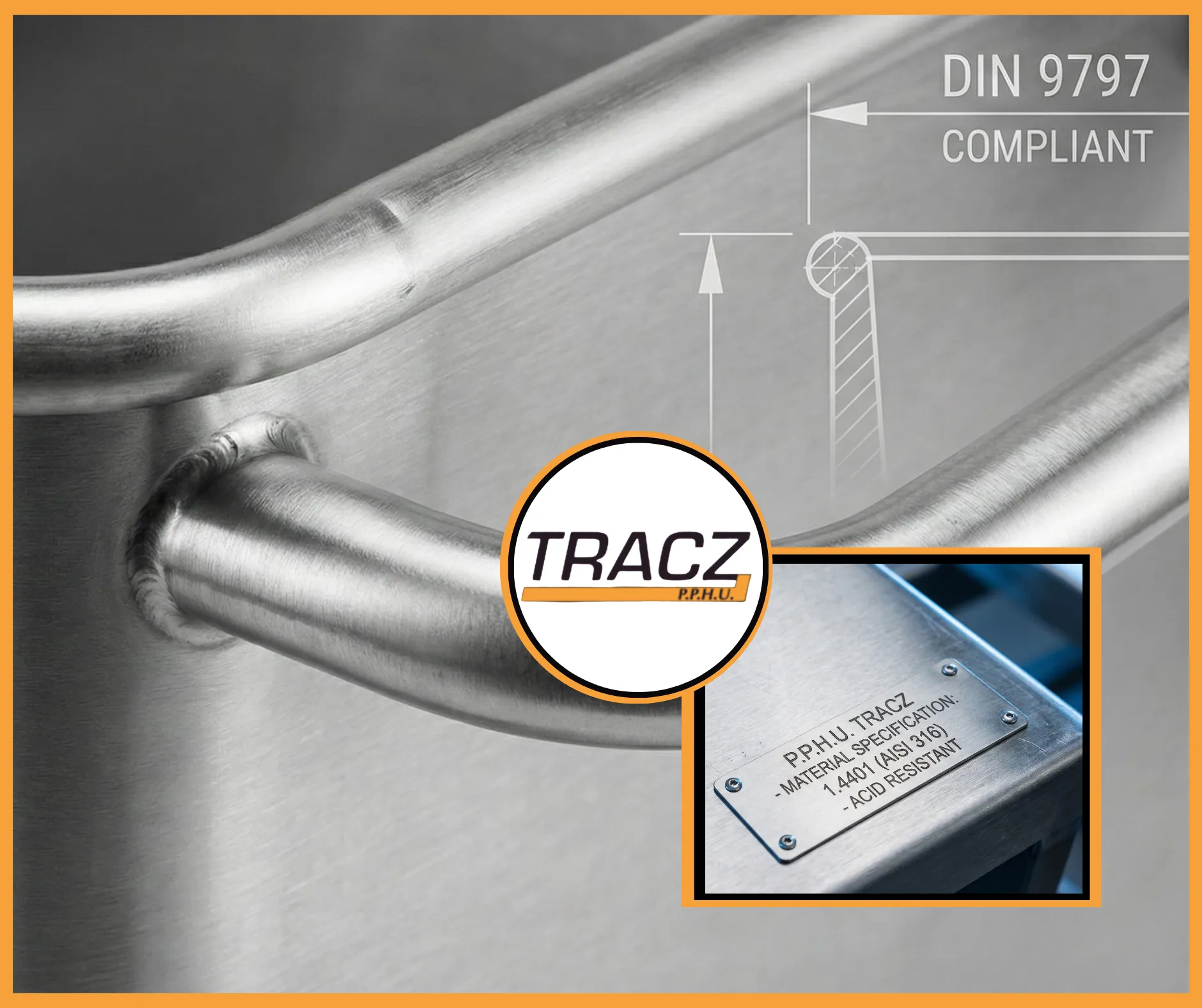

  • Geometry and welding: Professional butcher’s flip-flop P.P.H.U. The sawmill is made of acid-resistant steel with a full smelting of welds, which eliminates gaps in which bacteria could develop.
  • Mechanical Durability: Our designs are designed for ‘heavy duty’, withstand loads that immediately deform economic wheelbarrows.

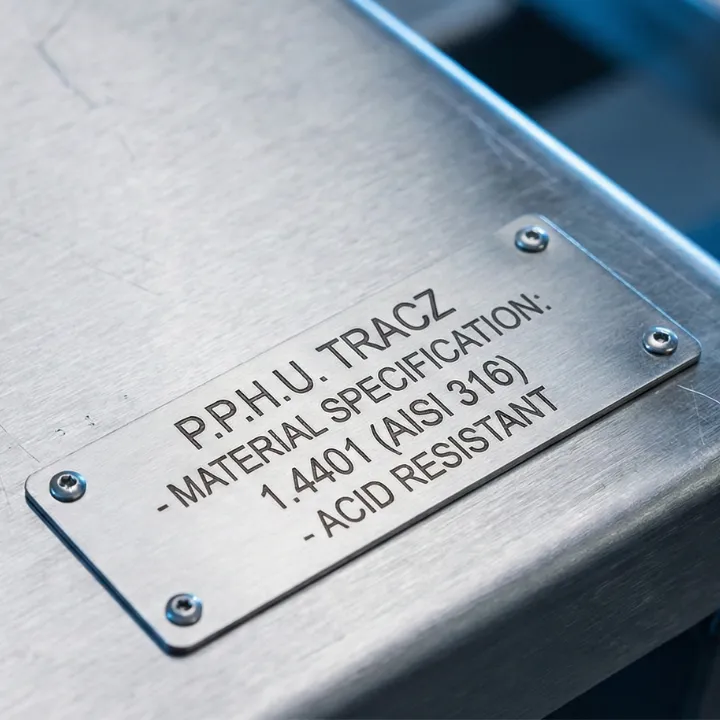

Standard Steel: 1.4301 (AISI 304 equivalent)
It is the most popular stainless steel in the food industry. It is resistant to water and standard detergents, but in the case of strong brines and chlorine-based detergents, it can undergo pitting corrosion.
Premium Steel: 1.4401 (AISI 316 equivalent)
It is acid-resistant steel with increased chloride resistance.
  • Application: curing, production of long-ripening cold meats and departments where aggressive washing chemistry is used.
  • investment: Though more expensive to buy, ‘Japanese’ or ‘Cymber’ made of 1.4401 steel (316) is a type of solution Anti-Corrosion Heavy Dutywhich eliminates the need for premature equipment replacement.
Tip from the expert Tracz: If your production line works in a highly salted environment, the choice of 1.4401 steel (316) is the only guarantee that the truck will not be corroded after several months of use

Standard DIN 9797: Automation Access Code
Most market offers give DIN 9797 as a dry fact. for P.P.H.U. Tracz is the foundation of technological compatibility
. Stuffing trolley (commonly called “Cymbre”) with a capacity of 200L or 300L must meet this standard for two reasons:
  • Compatibility with tippers: The standard determines the track width and side slides, which ensures that the trolley will fit on pole lifts of brands such as Ekomex, Laska or Seydelmann.
  • work safety: The lack of precise adjustment to the elevator is the risk of a full trolley falling (approx. 200-300 kg of stuffing), which is a critical threat to the staff.
